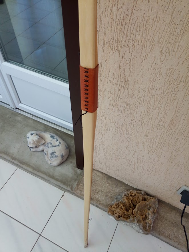

Couture
AM-JKLUvUWLRi2o6aRXx_tSTC4KTEDh5uDEo_6On-MAiEKOsE6qF1JyqFmfT7YVnJPI5vnJdzPzVFW4EqRJICFYqnBn-iwhIuyo3bMvF9ejgHn_gR8_BlRr3kLNrnsUXN4-iLhcXPaq3msR8jJTL2ScUClFgLA=w1178-h883-no?authuser=0
AM-JKLXNho4Nq8TITZaR_KRzPpRH26r2OVKcE-inRMQeKHA_sH0-GYNeWMy3d8WUgFWvJhDaIwIJIKzqK1PwgomL5YRvleCr2PmtP56Xg7wF68XDIc4WKRiKhNtws2if-uYJ4HP9rm39GfjifbRHqqcvwQM9Kg=w663-h883-no?authuser=0
AM-JKLU1hz__G_9CyXG8TgC8ee8eFrGq58gkG5w1Xo1PaBU-K205OWcFGaTjQ7B1g6-YSKs3a3E5HNl2WlTPEMY8xi33Y9gh4Yf4d2Pru5qPPwiN9_1PjG6ovbiYYKJdlXG3lIDBKQJlyTdU8UFO-ijSeel2CA=w663-h883-no?authuser=0
Et voilà le résultat
AM-JKLXY_ojjdb6Y1qTDEGrsg-JmKXt3AcJt4Pb3gihQgmlfTcjEAn879aEv8ihv4xtHJnj_1Z2iBsR2cI5dfV-e7gC2T4DCjSC2BHlA_jut5EUj-pYzjYug4Z1Sd8MRjdQwnGJwF_XHN8YOAJ9gdrHDYFD7tQ=w1178-h883-no?authuser=0AM-JKLWPDhV6QVlBgJ7Y2PGUeC34lXBVzOputZQOOgEyxKN63rjFw3G79eUuvZpoGDL5SfeHgxMsDJv3_EUoZ0Ke344cTPDQ-FURId6xEB0nyBlPNuEA_45gh2VSGSVe-50ivZZ9gB-n3mOk0C5KTd-FV3MRTg=w663-h883-no?authuser=0
