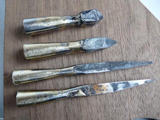

JMC Posted January 17, 2014 Share Posted January 17, 2014 voila une photo du premier essai.................... Quote Link to comment Share on other sites More sharing options...
