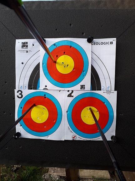

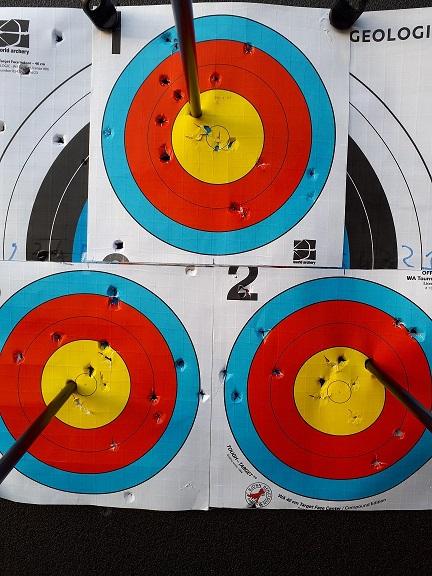

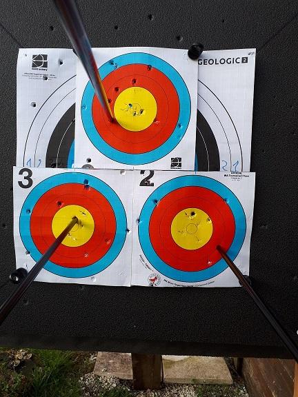

JMG Posted February 25 Share Posted February 25 les photos de notre ami Quote Link to comment Share on other sites More sharing options...
JMG Posted February 25 Share Posted February 25 c'est déjà pas mal 🙂 Quote Link to comment Share on other sites More sharing options...
